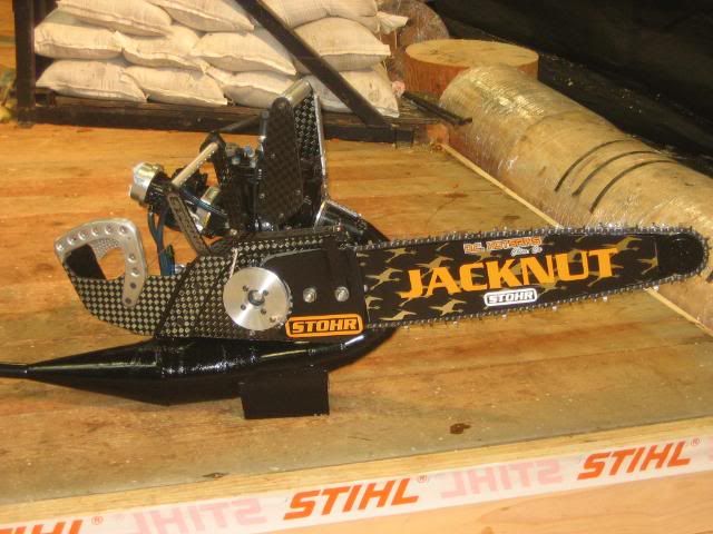

Anyone building or running a bikesaw? Here's a Carbon fiber framed 250 Honda we put together this winter for TJ Bexten to run in the STS......and it did win the qualifier. It's a shame TJ didn't make the finals, we were looking forward to running with the other fast bikesaws at STS in Pigeon Forge this June. The saw had another win at Missoula MT. just last week, so now we're considering going to Hayward WI. It's a long trip for us on the west coast, but I've made it before, back in 1996. Finished 3rd. We'll see.

Dennis, that's got to be the sickest looking saw you've built yet! :rock:

Gotta admit it... That one has "cool" factor... :cool!:

How much weight did the CF save over a traditional saw? Looks sweet.
Slightly under 10 lbs. There's still more CF to add, so the weight can come down more. Also, possible bar work could subtract weight.

Here's a look at the tooth of hi-tooth 404 racechain that we're experimenting with on the 250 Honda. We're still running 1/2" too.
