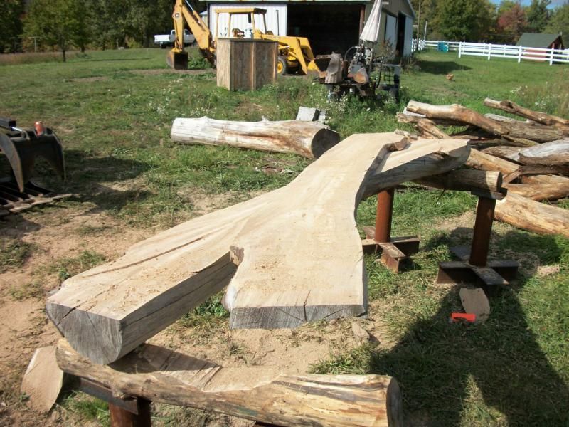

I've been wanting to build a wall gun holder, I'm too cheap to go buy one so I figured I'd mill some of the maple logs I've had for almost a year behind the barn. Good and dry and milled pretty easy, I think I have a air leak on the 066, gonna have to take a close look at that. It was fun to bolt the mill head back up and crack them logs open. I need more Sunday's like today!

Nice Frank! :cool:
That's some nice slabs of wood there - nice mill too. :)
You gonna put one firearm on each piece....??? Definitely can get pretty creative with whatcha got!
Nice stuff! I definitely want to get into some sort of milling setup eventually. You gotta follow up and show the gun racks when they're done :)

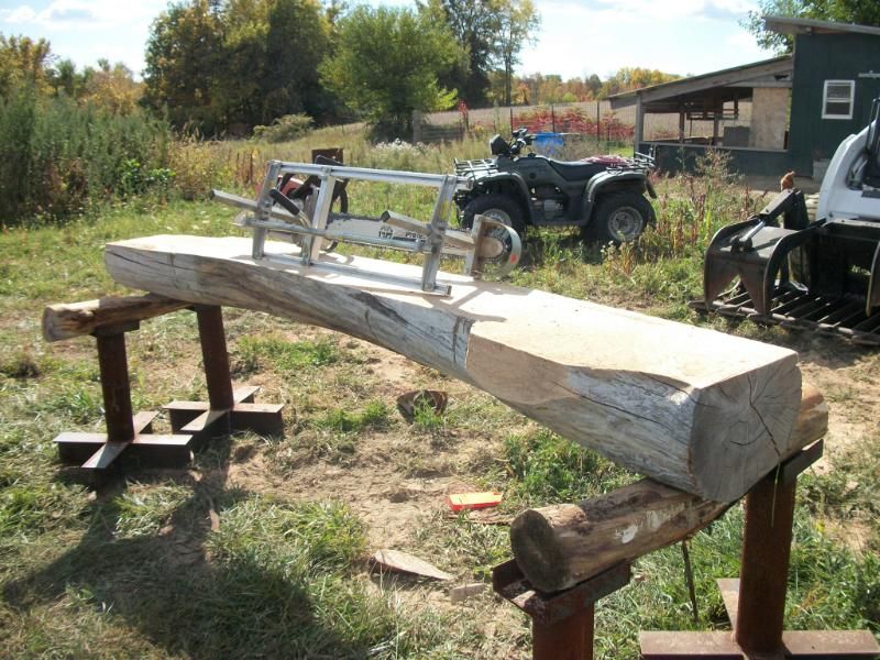

Fun getting into the milling isn't it ! And hey, your mill is on the wrong side of the bar !
I set mine up with the oil & fuel fillers facing up, I find it easier to refill the tanks right on the planks I'm cutting. Any particular reason you've got your power head on the low side of the log, rather than facing up ?

Haha! Well the best reason I can think of is just plain laziness! It went on easier, the bar needed slide out so the Power head would fit up and I didn't feel like doing it. Easy fix was flip the PH and push from the other direction! It works either way I guess I didn't find it any harder to fuel it or run it.

Well there's an ideer I might try someday. I've been using mine with the PH up, running the throttle with the index finger of the left hand. I guess with it the other way 'round, it'd be with the right hand. Might work better too, assuming you have enough bar to prevent the powerhead from getting into the log. I'd been using 16 and 18" bars and doing 14" diameter logs. You run out of blade right quick on those ones !
EDIT -- And there might be the other advantage... getting the heat and noise from the engine on the bottom, might be less tiring to the ears your way. The 181 Husky with the extra-loud muffler I had been using was getting old to listen to after 4-5 hours a day !

Ya, I don't know if it is any better or not, wasn't even a thought process when I did it! Just knew I didn't feel like loosening up the bar clamps on the mill head and slide it out so the PH would fit up. Seemed easier to mount this way. I could foresee some problems if you had to mill close to the ground with the PH facing downward.

Any problems with the exhaust location with the PH upside down like that? Might get the timber a bit hot on long slow cuts
