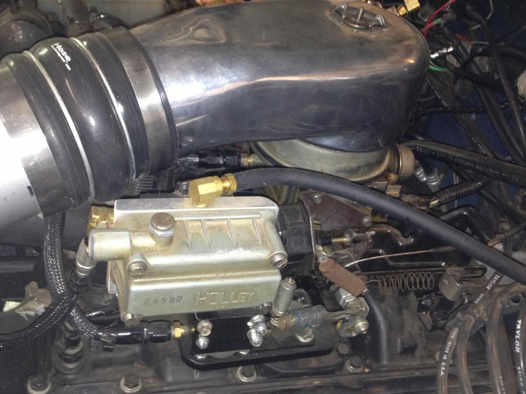

Here is my Dad's knock about 1990 Dodge Ram 150 Longbed with a 318 that we kept the TBI fuel injection on. The truck was given to Dad by a friend from Church by the way....
Here is the mod list:
76,000 miles on the truck
318 Stock shortblock engine with newer Magnum heads, ARP Studs and Cometic gaskets, and a 360 TBI intake manifold modified (welded and re-drilled) to fit the magnum bolt pattern heads
Hedman headers- ceramic coated
Full Mandrel dual 2.5 inch exhaust out to a Walker X-flow muffler and some swirly tip thingies in the ends of the exhaust pipes that exit before the back tire.
Used the larger 360 TBI throttle body and injectors, running a fully adjustable Paxton Rising Rate Regulator and a Custom made acceleration enrichment circuit via a Holley bowl and an accelerator pump nozzle installed inside the TBI (my Dad REALLY wanted to keep the stock fuel injection, so there were a lot of "interesting" fixes that I came up with to make it work)
Running a Ford GT500 (2009) Eaton 122? Supercharger that is mounted off to the side over the driver's side header that blows through the TBI. Currently running a small pulley on the supercharger (2.8?) and a custom made 10 rib crank pulley that fits down inside of the stock V-belt pulley. Had a friendly local water-jet cutting shop that did the CAD drawing and cut the plate mounts to my design out of 1/2 aluminum plate. I think the tensioner is a 10 rib unit out of a Napa parts box for a Navistar Big truck of some kind.... I was raiding the store and looking through boxes.... haha
Runs about 6.5-7psi of boost in summer and 8.5-9 in Texas winters and he has a Wideband o2 gauge that he can keep an eye on when boosting it..... runs about 11.5:1 AFR at WOT.... I told him if he sees it go over 12.5 to LET OUT!!! The stock cast pistons are pretty dang tough obviously...
