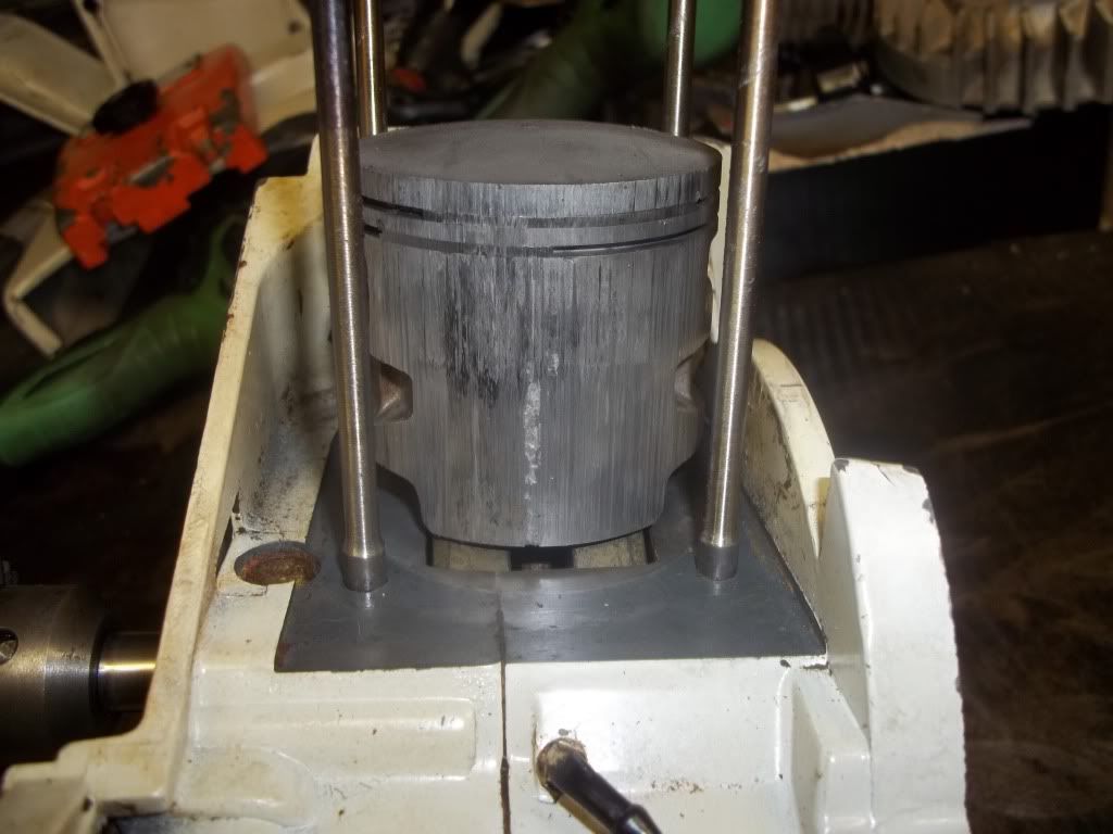

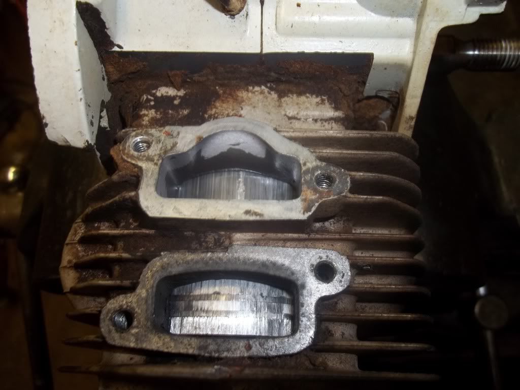

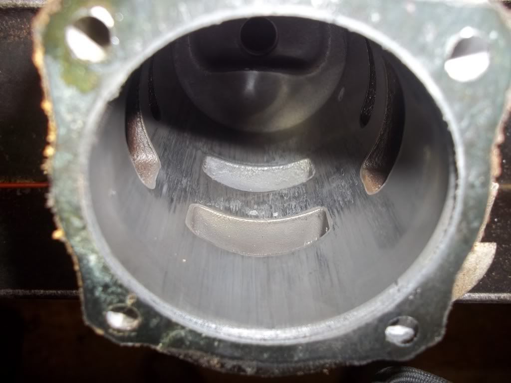

I got the piston done and the cyl ported. No pics of the cyl yet.
Laid out for popup. The 075's have a spherical piston top so and an offset D-shaped combustion chamber. So i welded a popup on it & turned it down.
Here's some pics of how much I opened up the windows.
The piston is almost an oz. lighter than stock. I don't polish the work I do on the piston or transfers to aid in atomization of the fuel/air mix going into the combustion chamber.
Also the pits on the top have been filled.
I'll admit that this is not my best work, but I've got all new tools to work with & not in the groove yet.
