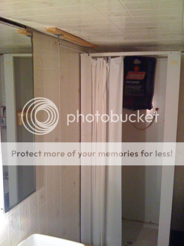

This is what I had to start out with. It really wasn't much at the time and it was an interesting three and a half years dealing with having only this as a bathroom!!

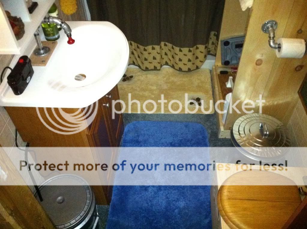

Here it was all completed. I took me about a month to build it. I spent a lot of time (as always) just staring and wondering what to do and how to go about it. Things came to gether one by one and I'm actually really happy with how it all turned out!! It's fully functional. I've got water flow for both the sink and shower with the help of the battery powered pumps (4D batteries to power the pumps, the pumps turn on with the red on/off toggle switch on the batter pack). I was going to make my own pump system but these things are only $30 at Gander Mountain. These camp pumps are freakin' great! I have changed the batteries once in the shower pump and the originals are still in the sink pump. In a year I've pumped water for the sink and shower with only 12 D size batteries! The reservoir for the sink is the 5 gallon bucket on the floor, and the reservoir for the shower is the red 4 gallon pot on the shelf. The metal rod with the cord attached to it is a bucket heater - in 30 minutes the water is hot enough to take a shower (in 45 minutes the water boils, it's a good bucket heater!). The toilet is the compost toilet. You do your business (number 1 or number 2) and you cover it up with the peat moss I have in the metal barrel next to the toilet. Toilet paper and everything gets composted. The receptacle is a 5 gallon bucket, when it's full you empty it out into the compost pile outside. In one year you have highly nutrient enriched composted soil for gardens. The toilet paper holder was my favorite accent of everything. It just popped into my head and I went with it - I figured it'd be a nice touch and a cool way to keep using pipes and not just limit their use for directing the hose for the pump through them for the water. Gotta turn the shower on and off while using it as you only have 4 gallons but it's definitely more than enough water. The wife loves the whole deal. It's been about a year since we've had this bathroom and it's cool as hell I was able to put this all together.

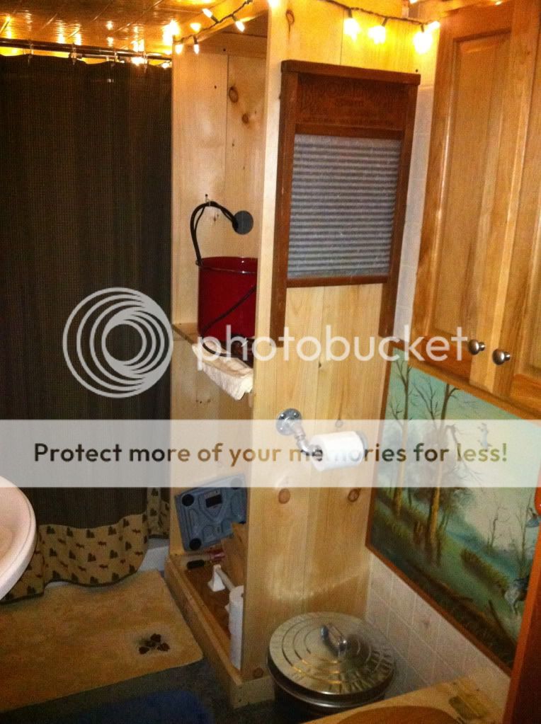

Here's the 4 1/2 gallon pot I use for the heated shower. It has the pump going to it along with the bucket heater. If the heater runs for more than a half an hour or so the water gets scolding hot! I'd like to build a thermostat control for it which would be pretty cool. But for now I just use an oven timer and when it goes off it's about ready.
Here's the shower. You'll see the shower head along with the control / battery box for the pump.

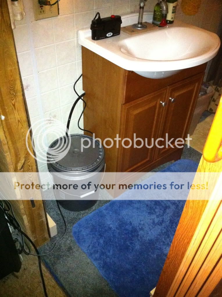

Here's the sink. Same idea, only it;s in a plastic bucket and the water is not heated.
Now the compost toilet. It's very simple. It's a wooden box that has a closing lid (with a toilet seat) and a circular opening that fits over a 5 gallon bucket. It gets a few inches of peat moss / saw dust at the bottom, then you do your business and cover it up when you're done. When the bucket is full you add it to your compost pile outside then clean the bucket out. No odor, no smell. That's it. Works awesome and there's no better way of doing it IMO.
Custom made TP dispenser!
