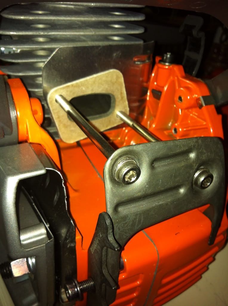

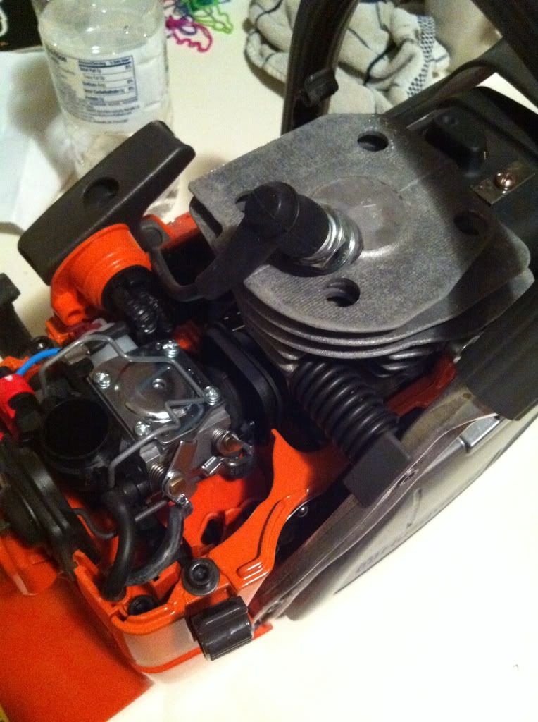

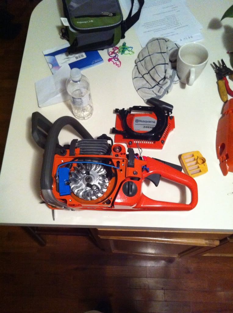

First things first...and yes, that is the kitchen island :)
Ahhh....much better!!

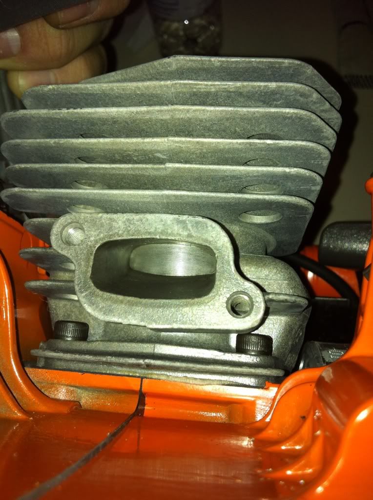

Yep, there's a piston in there...

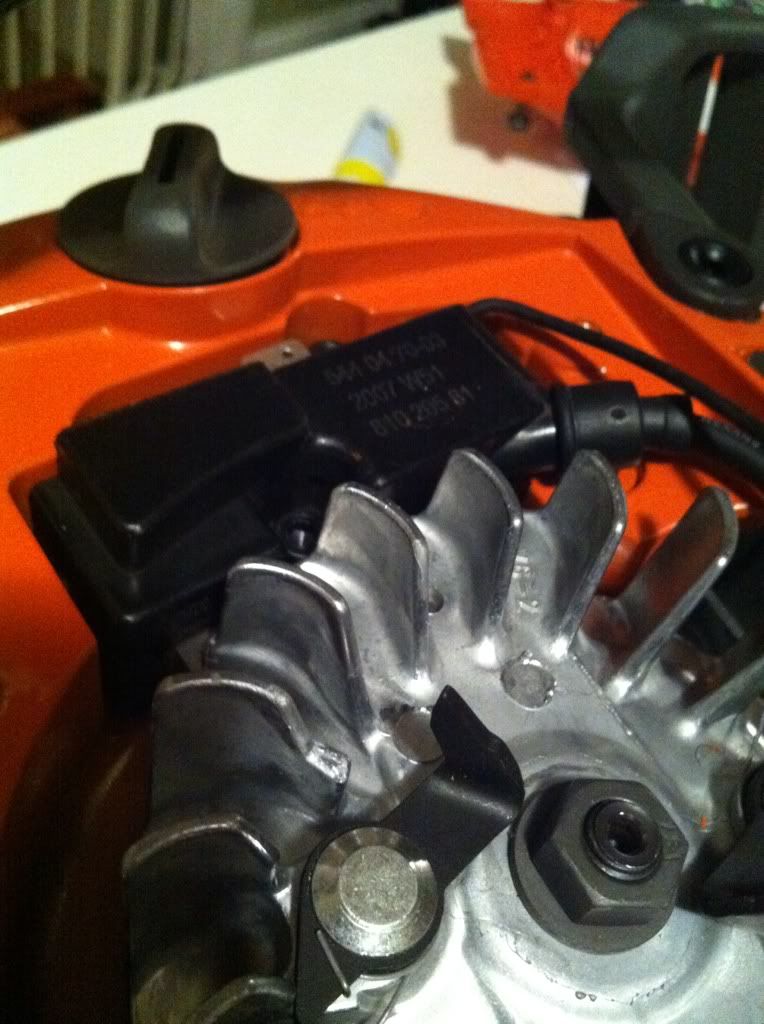

Still gotta get that freaking clutch off so I can put a 3/8 rim on it. Hopefully I can get it off without buying the tool...
